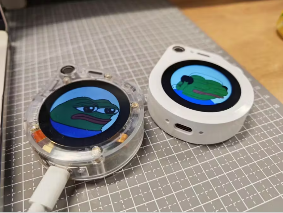

What is the SenseCAP Watcher?
The SenseCAP Watcher is part of the SenseCAP family of IoT devices. SenseCAP Watcher is built on ESP32S3, incorporating a Himax WiseEye2 HX6538 AI chip with Arm Cortex-M55 & Ethos-U55, excelling in image and vector data processing. Equipped with a camera, microphone, speaker, SenseCAP Watcher can see, hear, talk. Plus, with LLM-enabled SenseCraft suite, SenseCAP Watcher understands your commands, perceives its surroundings, and triggers actions accordingly. It features:
- ESP32-S3 MCU: A dual-core processor with built-in AI acceleration and low-power capabilities.
- Onboard Microphone: Perfect for audio input, such as voice commands or speech recognition.
- Wi-Fi and Bluetooth: Provides seamless connectivity to the cloud and other devices.
- Compact Design: Designed for IoT applications with minimal space requirements.
Its powerful ESP32-S3 chip makes it ideal for AI applications, especially those that require real-time processing, such as voice recognition and natural language understanding.
