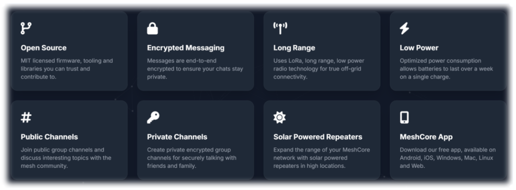

Why Choose MeshCore Technology?

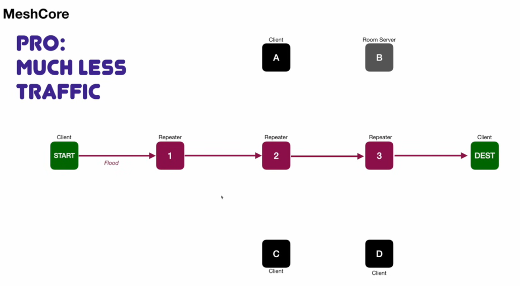

MeshCore™ represents an innovative LoRa-based mesh networking system designed for flexible, role-based off-grid communication. Unlike traditional approaches, MeshCore introduces clear node specialization – enabling efficient point-to-point transmission over short distances while utilizing dedicated repeater devices for long-range signal extension.
(Diagram credit: Vivian van Zyl)
The most prominent advantage of MeshCore technology lies in its low power consumption. The device does not need to constantly broadcast its own information, which significantly reduces energy consumption, allowing the device to have a longer battery life in emergency scenarios.
The MeshCore network is particularly suitable for the following application scenarios:
  • Emergency Communication: quickly deployed in emergency situations
  • Precise Positioning: Rescue tasks requiring precise positioning
  • Private Network: MeshCore can let you set up a network with just a few devices

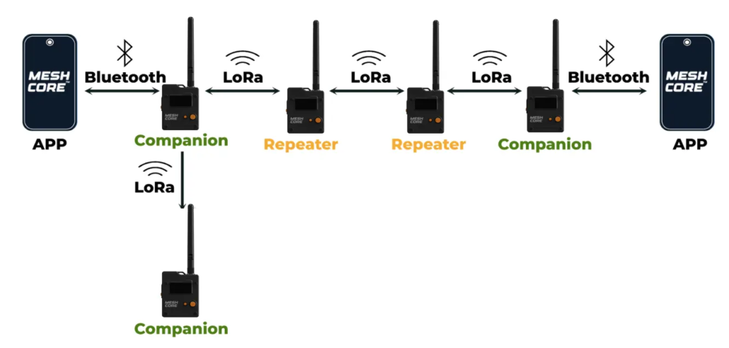

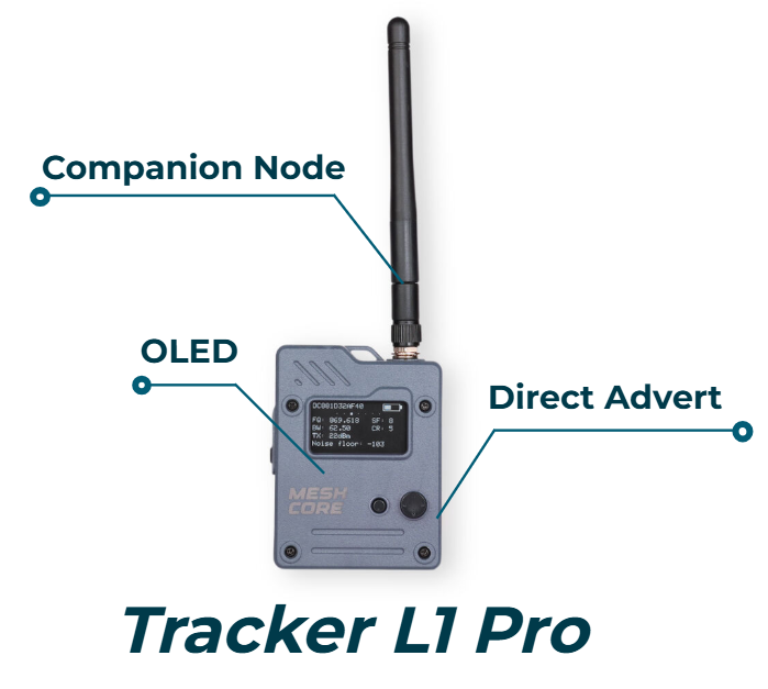

Choose Your Portable Nodes (Companion)
In MeshCore network, companion nodes serve as portable endpoints. In short communication distance, devices can perform peer-to-peer communication after exchanging advert. A simple click of the button can easily broadcast your location.
Recommended DeviceFirmwareSpecificationApplication Scenario
Wio Tracker L1 ProBluetooth CompanionOLED Screen
5-day Battery Life
Direct Advert Sending
Hiking
Camping
Geek

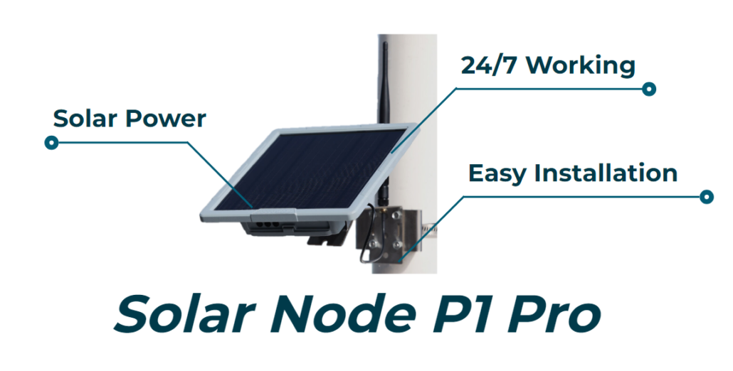

Expanding Your Network by Repeater
In MeshCore network, repeater can relay messages when two companions are out of communication range. The SenseCAP Solar Node is the perfect choice for MeshCore repeater, as solar can power it continuously.
SenseCAP Solar NodeRepeaterSolar Power
Easy Installed
Low Power Consumption
Camp Signal Coverage
Data Relaying
Large-scale SAR
All products above arrives with factory-flashed MeshCore firmware, enabling easy-configuration deployment.

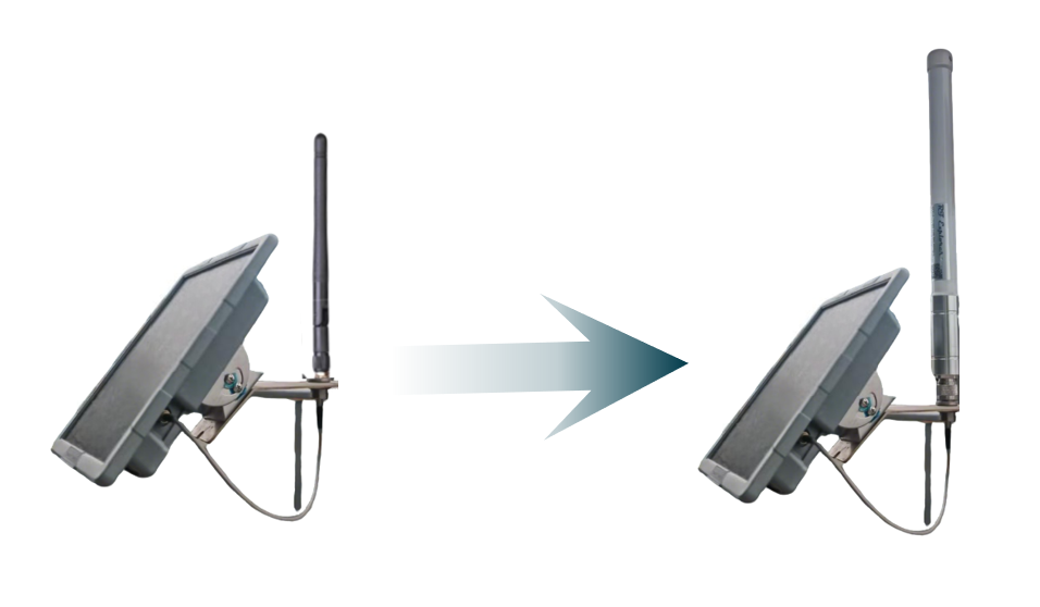

Tip 1: Upgrade Your Antenna
Switching to a “high-gain” antenna is the easiest way to boost your distance and signal quality.
860-930MHz-3dBi-360mm902-928MHz-5.8dBi-800mm863-870MHz-8dBi-1300mm902-930MHz-8dBi-1300mm
LinkLinkLinkLink

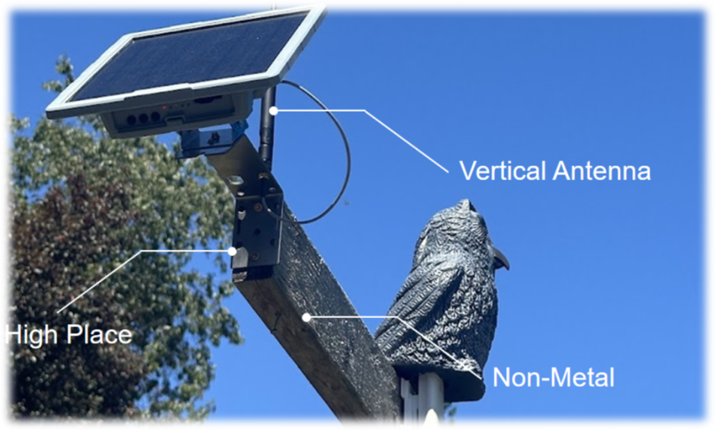

Tip 2: Suitable Installation:
Generally, installing the repeater at a higher position will result in better signal coverage. Please ensure that the external antenna of your device is kept as vertical as possible and kept away from metal objects.

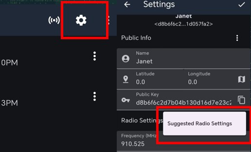

For Wio Tracker L1 Pro
  1. Download the App: Get the MeshCore App from the Apple App Store or the official MeshCore website.
  2. Connect: Turn on your device and pair it with your phone via Bluetooth.
  3. Set Your Region: The only main setting you need to change is your LoRa region (all Seeed products support the 863 MHz to 928 MHz bands).
Once your companion nodes are set to the same frequency, they will automatically start communicating. It’s that simple & happy meshing!

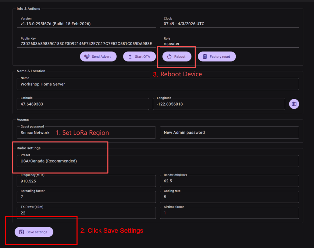

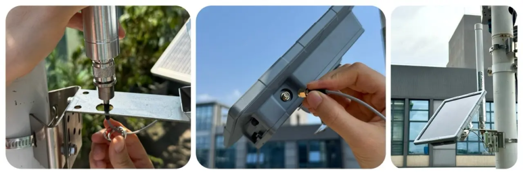

For Solar Node P1 Pro
Connect to Serial Configuration Tool: Connect your device to computer via USB cable. Turn on your device and open the configuration page. Change LoRa setting
Then your repeater will start relaying messages in your preferred frequency band.

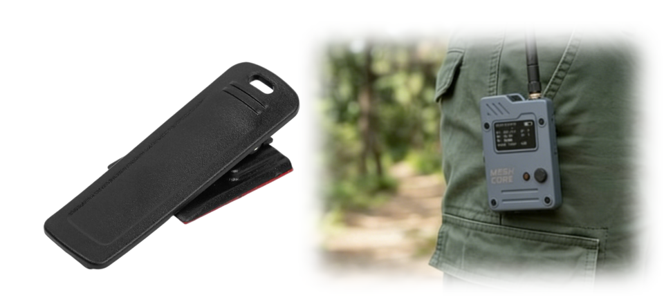

  • Portable:
We provide back clip with industrial durability, Keeping your tracker accessible and easy to carry during daily activities without adding bulk
Also we provide nylon lanyard for L1 Pro to hang on bag or your neck.
  • Antenna Upgrades: Fiberglass antennas deliver plug-and-play range enhancement for your MeshCore repeater infrastructure. You can choose : 5.8 dBi antenna and 3dBi antenna
