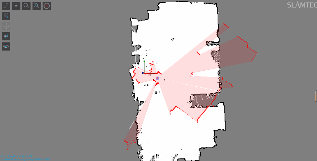

The user performs a limit detection distance test on the aisle shown in the above figure.
The detection distance is controlled by the back and forth movement of a baffle, and the detection limit distance of Mapper is about 20.7 m, which is consistent with the radar detection distance of 20 m on key performance indicators.

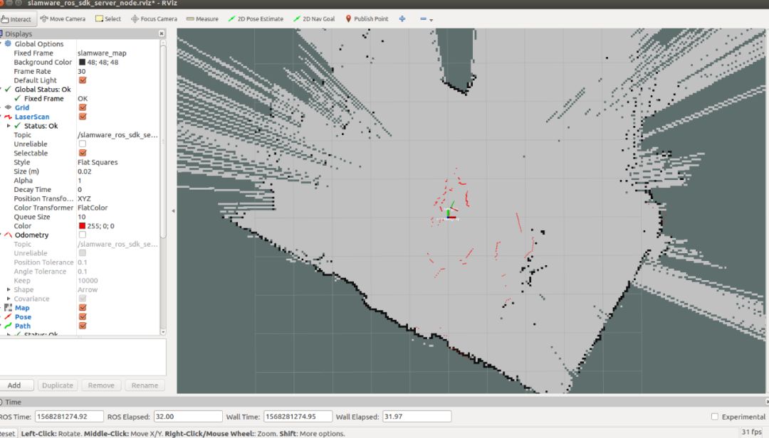

Development in the ROS environment
Excellent mapping performance
High-quality maps building in the large scenes
I carried out a hand-held construction in a room with an environmental area of 500 square meters and 1000 square meters. The effect of the construction is shown in Figure 1 and Figure 2.
The hand-held mode is better in the construction of the map. The map features in Figure 1 are more obvious. There is no skew in the corridor, and the right-angle features are more accurate. In Figure 2, there was a large tilt at the beginning, which did not affect the subsequent construction. The left corridor appeared slightly skewed.

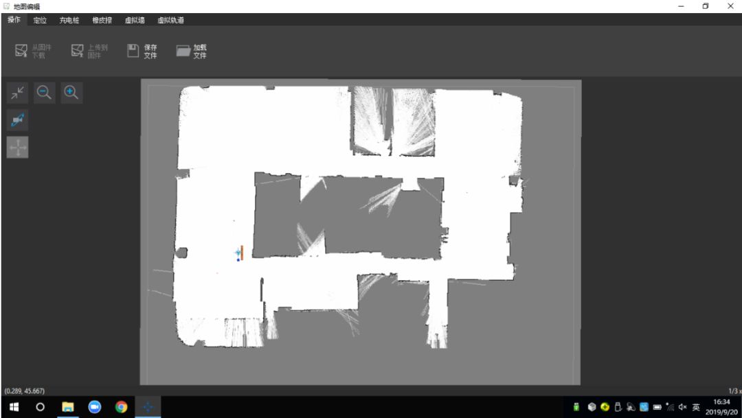

Closing loop
We test in the company, the size is about 100m * 60m, starting from the starting point, passing through the station, corridor, tea room, meeting room.
There are a lot of glass panels on the way, after a lap, back to the starting point, the final map is as follows:
Conclusion: As we can see in the figure above, in the current size of the area, M1M1 can completely control all kinds of complicated conditions. When returning to the starting point, there is basically no cumulative drift or overlap
The reconstructed map is very close to the actual size. Because there is no professional equipment measurement, accurate values cannot be given.
Failure Case: M1M1 could not work only when it was close to the glass door and the light was too bright. In other cases, it could successfully locate and map.

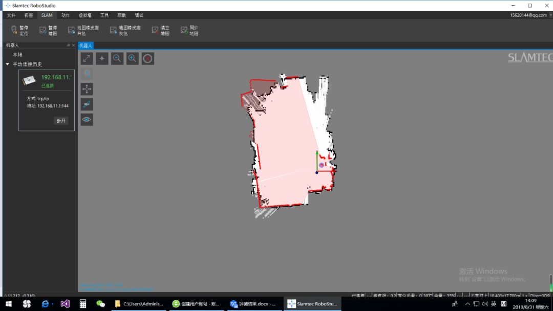

High-performance when mapping in the complex environments (bright/dark)
Turning on and off the light in a complex laboratory environment:
Figure 3 Turn on the light
Figure 3 Turn off the light
The above two tests were both under the handheld mode, and a model of the drawing was obtained around a circle in the laboratory. Although there are many internal types of equipment in the laboratory and the road conditions are complicated, the complete contour information can be obtained by two tests in only a one-time walk. Figure 3 shows the test carried out under the condition that the laboratory light is fully open. Figure 4 shows the results of the construction of all the lights in the laboratory and the black state.
