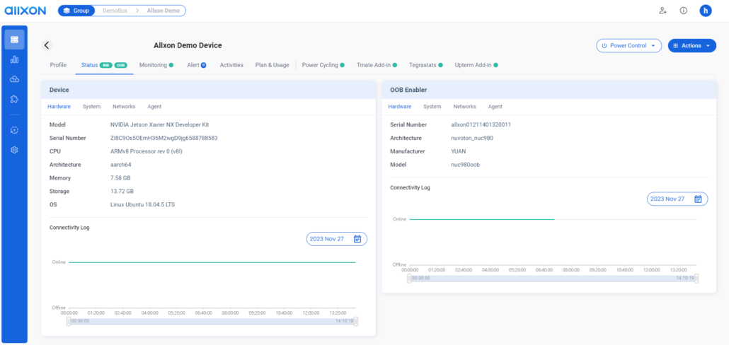

Edge device fleet management by Allxon
Through Allxon’s Fleet Management Solution, the University of Waterloo can remotely manage and monitor the status of the NVIDIA Jetson Orin NX devices in real time. In case of device abnormalities, Allxon Out-Of-Band Technology allows remote system rebooting, eliminating preliminary device issues that may jeopardize safety on the road. Additionally, Allxon offers Over-The-Air (OTA) update functionalities, enabling bulk updates of software, containers, or system configurations remotely. This allows the University of Waterloo to swiftly update all deployed devices on campus after each development, ensuring that all projects continuously run smoothly on the latest versions.
