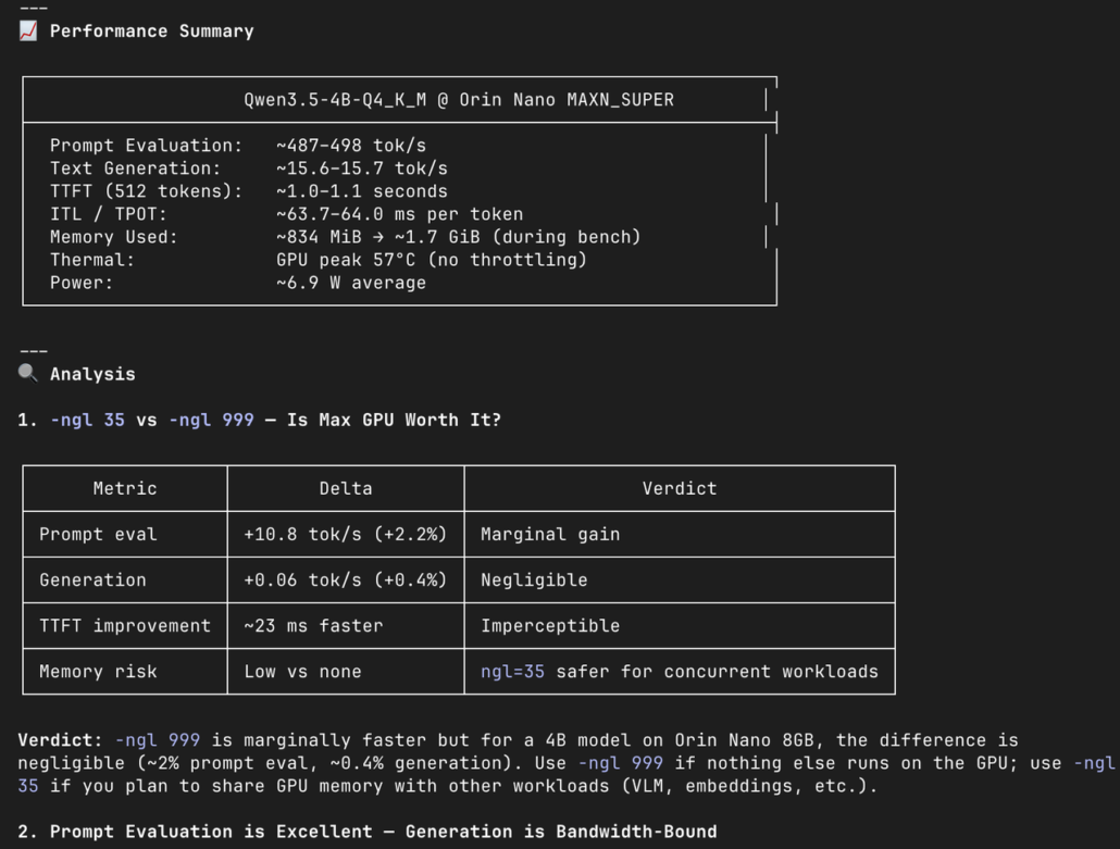

Edge LLM Inference Test: Memory Usage Plummets by 40%
To intuitive demonstrate performance gains in Generative AI scenarios, we conducted inference tests on the Qwen3.5-27B-Q4_K_M model using an AGX Orin 32GB. Thanks to memory optimizations in TensorRT-Edge-LLM 0.8.0(Powered by CUDA 13 optimizations and the increased compute performance provided by Super Mode), we achieved stunning results:
MetricJetPack 6.2JetPack 7.2Improvement
Memory Usage24.6 GB14.7 GB📉 ~40% Reduction
Prompt Processing18.2 tok/s25.8 tok/s🚀 41.8% Faster
Token Generation4.3 tok/s5.5 tok/s🚀 27.9% Faster
The reclaimed ~10GB of memory makes multi-service co-deployment possible, allowing even the GR00T N1.7 dual-module VLA to load completely on Orin.
