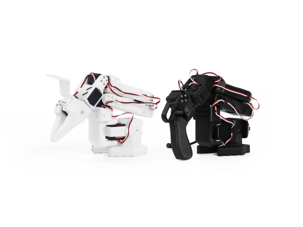

SO-ARM101 Assemble KitSO-ARM101 Assemble Kithttps://www.seeedstudio.com/SO-ARM-101-Assembled-Kit-Pro-p-6691.html(Each kit includes one Leader arm and one Follower arm)×2
USB CameraUSB Camerahttps://www.seeedstudio.com/ET-S231-90-USB-Camera-p-6684.html× 1~2(The exact number depends on the training task)
PC / NVIDIA Edge Computing PlatformPC / NVIDIA Edge Computing Platformhttps://www.seeedstudio.com/reComputer-Robotics-J4012-with-GMSL-extension-board-p-6537.html×1
The SO-ARM101 is officially supported by the LeRobot ecosystem, which means you can avoid a lot of low-level hardware and driver integration work and get started much faster.
Here are some of its key advantages:
  • Ready-to-use leader-follower architecture: Designed for teleoperation out of the box, with no need to develop your own low-level drivers.
  • A strong community and ecosystem: Standardized imitation learning dataset formats, extensive community resources, and detailed tutorials make it accessible to beginners.
  • CAN FD servo motors: Stable, low-latency communication makes the platform suitable for synchronized, high-quality data collection.
  • Fully open source: Includes mechanical STP files, hardware BOMs, and software SDKs.
  • Affordable: Significantly more accessible than traditional research-grade bimanual robot platforms.

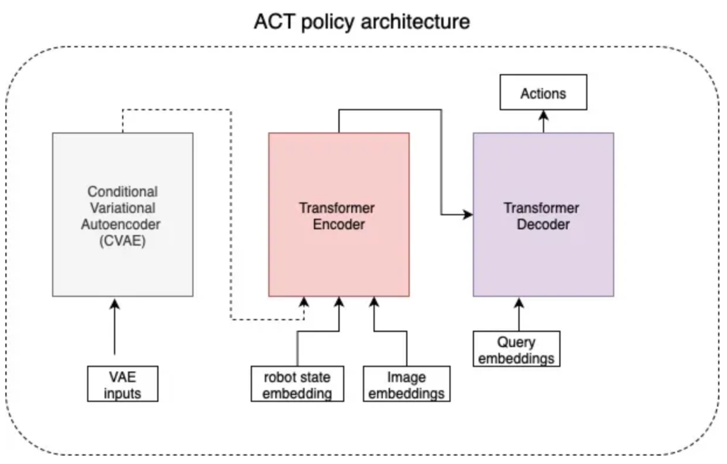

For tabletop manipulation, ACT (Action Chunking with Transformers) has become one of the most widely used policy architectures.
ACT was introduced by researchers at Stanford alongside the ALOHA system. Its key idea is action chunking.
Instead of predicting only one action at a time, which can cause small errors to accumulate over a long sequence, ACT predicts a sequence of future actions—a so-called action chunk—and executes these actions as a coherent sequence.
This helps reduce the error accumulation associated with purely single-step action prediction.
ACT has several important advantages:
  1. Smoother motion: Predicting a sequence of actions helps reduce the jitter that can occur when making independent frame-by-frame decisions.
  2. Improved robustness: Action chunking can reduce error accumulation and make long-horizon manipulation tasks more stable.
  3. Multimodal behavior modeling: ACT uses a CVAE-based architecture to model multiple valid ways of performing the same task.
As a commonly supported policy in robot learning frameworks such as LeRobot, ACT has been demonstrated on a variety of fine-grained manipulation tasks, including object grasping, component assembly, and cloth manipulation.

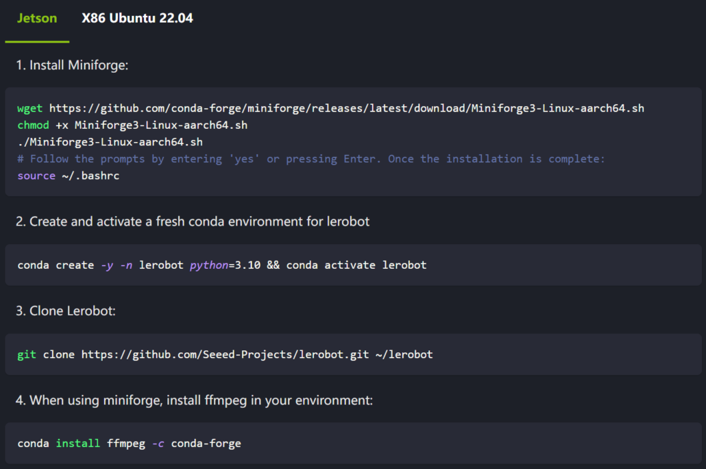

Step 0 — Set Up the LeRobot Environment
First, install the required software dependencies.
The tutorial provides installation instructions for both Jetson and Ubuntu, including the required packages and commands.
The goal of this step is to prepare the complete software environment for robot control, data collection, and model training.

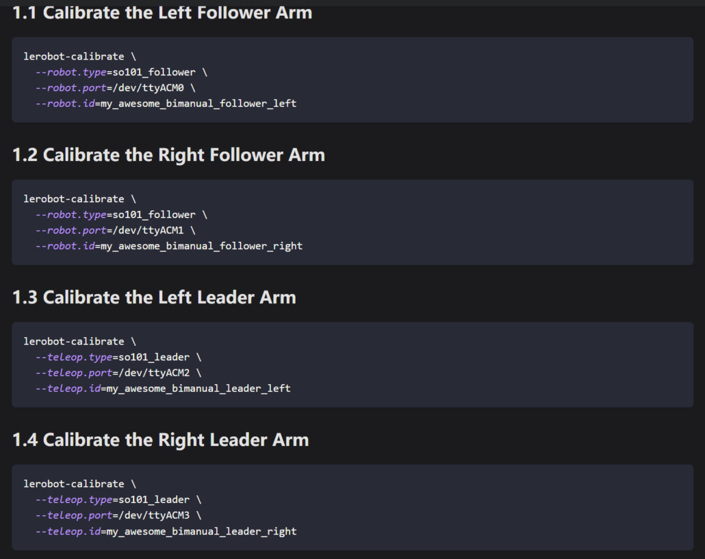

Step 1 — Calibrate the Robot Arms
Calibrate the joints on all four arms—the two Leader arms and two Follower arms.
The purpose of calibration is to establish the correct zero positions, movement directions, and operating ranges for each joint, allowing LeRobot to correctly interpret and control the robot.

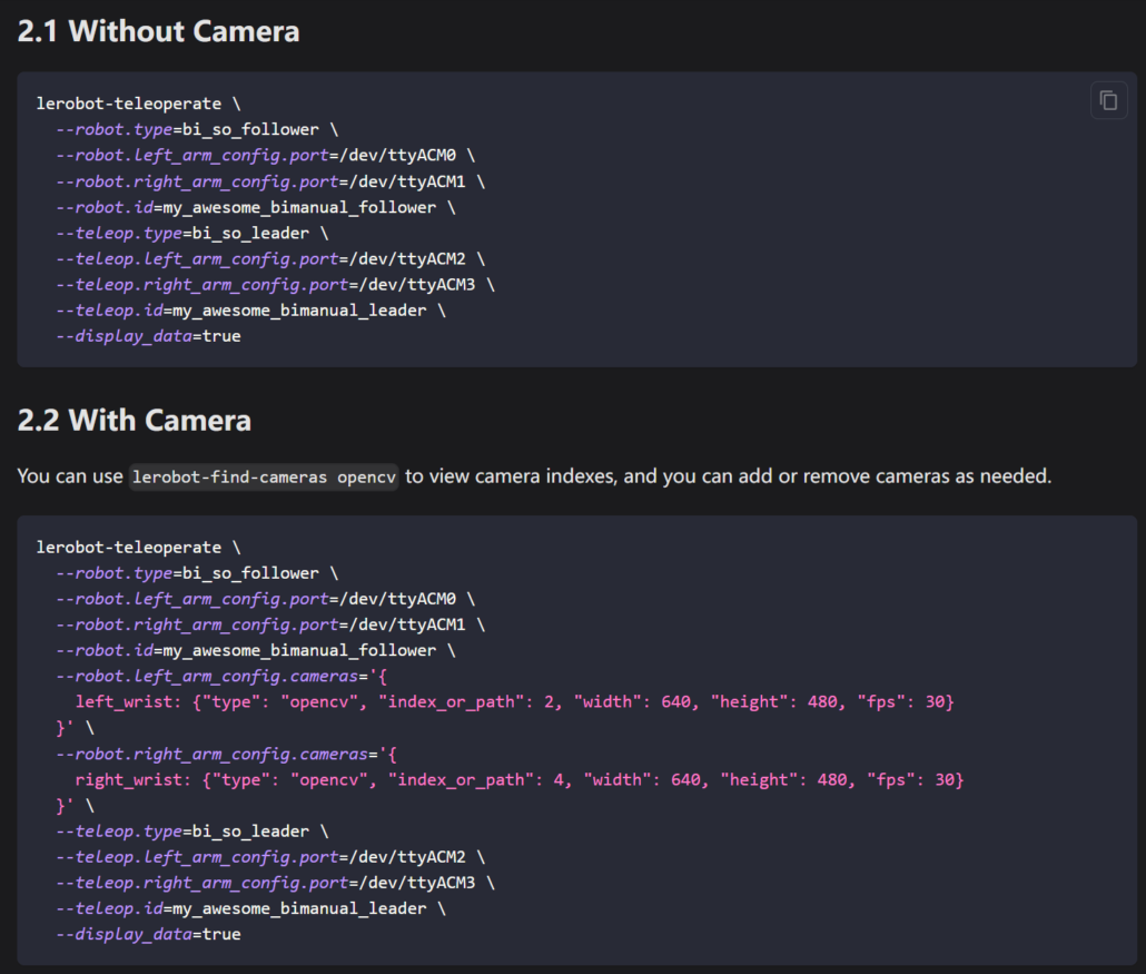

Step 2 — Leader-Follower Teleoperation
Once calibration is complete, you can start teleoperation: move the Leader arm, and the Follower arm mirrors its movements.
The teleoperation stage without cameras is mainly used to verify that the robot control pipeline works correctly.
Once cameras are added, the system can simultaneously capture visual observations and robot actions, providing the data needed for imitation learning.

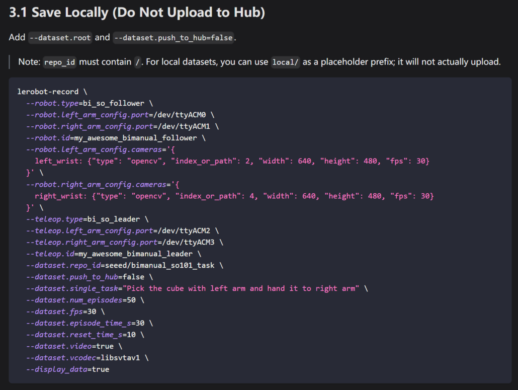

Step 3 — Dataset Recording and Management
The operator performs the task through the Leader arms while the system synchronously records what the robot sees and what the robot does.
This creates the demonstration data that ACT will later learn from.
In the tutorial, 50 episodes are recorded using num_episodes=50.
The tutorial also covers how to:
  • Upload datasets to the Hugging Face Hub
  • Resume an interrupted recording session
  • Replay recorded episodes
  • Delete unwanted episodes
  • Manage and inspect the collected dataset

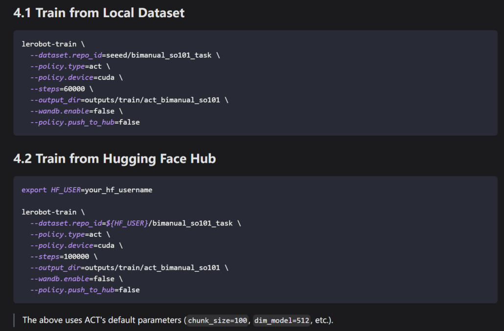

Step 4 — Train the ACT Policy
Now comes the exciting part: training!
LeRobot provides a simple training command that handles the training pipeline for you. The tutorial also introduces basic hyperparameter tuning and ways to visualize the training process.

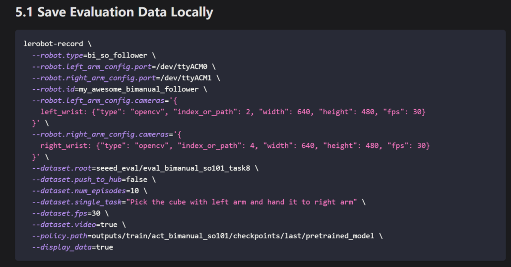

Step 5 — Deploy the Policy on the Real Robot
Once training is complete, you can save the trained model and evaluate it on the real robot. The tutorial also covers both local model storage and Hugging Face-based workflows.

Q8: How long does ACT training take?
On a mid-range GPU, a simple task with around 50 demonstrations may take roughly 1–2 hours to train. Actual training time depends on the GPU, dataset size, task complexity, image resolution, and training configuration.
