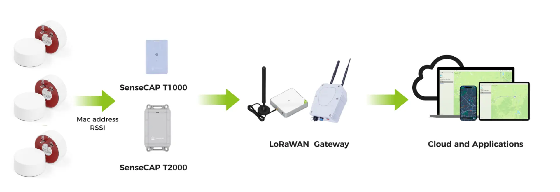

The Hybrid Positioning Concept: Use Each Radio for What It Does Best
A robust mining tracking system does not rely on a single wireless technology. It layers three complementary radios, each assigned a specific job:
LayerTechnologyJobWhy it fits
Outdoor PositioningGNSSAbsolute coordinates in open-sky areasFree, global, meter-level accuracy where sky is visible
Indoor PositioningBluetooth BeaconsRelative / zone-level position where GNSS failsLow cost, low power, works indoors and in RF-shadowed areas
BackhaulLoRaWANLong-range, low-power data uplink from tags to platformKilometre-scale range, months battery life, no per-device SIM
ManagementCloud / on-prem platformVisualisation, geofencing, alerts, reportingWhere the data becomes decisions
The key insight: the tag does not need to send its position over a high-power cellular modem. It can determine its position and then ship a tiny payload over LoRaWAN.

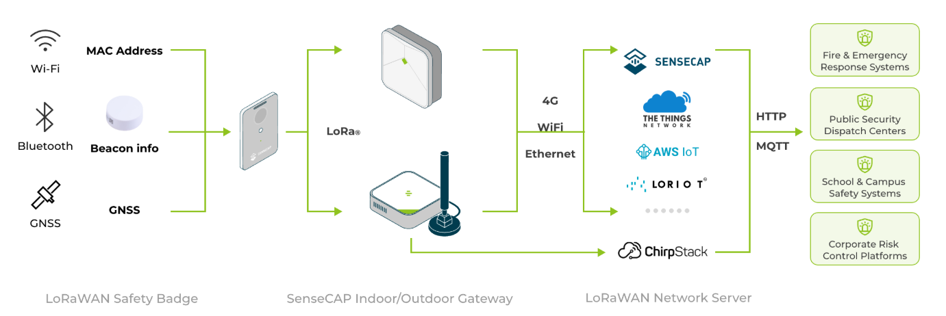

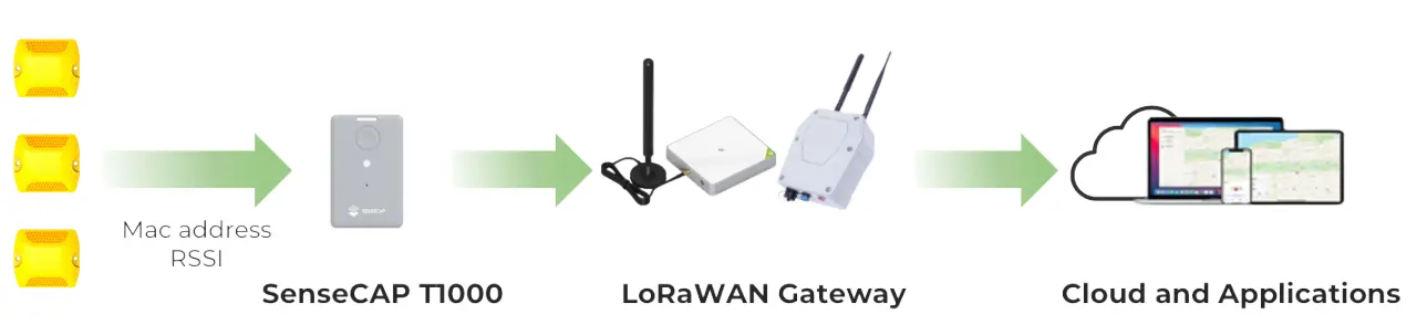

Underground and enclosed spaces: BLE Beacon + LoRaWAN
As the miner descends deeper into the pit, walks behind a high wall, or enters a maintenance workshop, GNSS becomes unreliable or unavailable. The tag automatically falls back to BLE: it scans for nearby fixed Bluetooth beacons, reads the MAC addresses and RSSI of the strongest beacons, and sends that list over LoRaWAN. The platform then resolves the tag’s position to a triangulated position within a few metres.

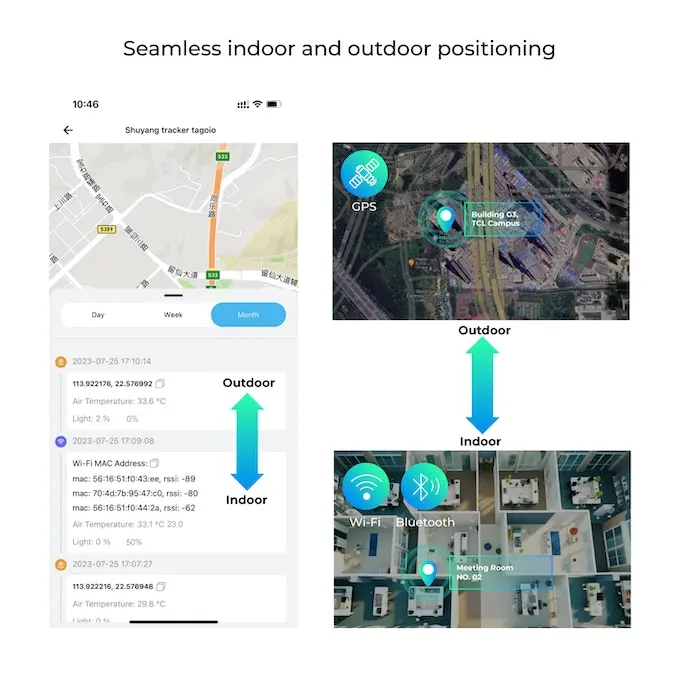

The handoff is seamless to the user
From the platform operator’s perspective, the tag always reports a location. Whether that location came from GNSS coordinates or a beacon ID is a detail the system handles automatically. The operator sees a dot on a map, a name, a timestamp, and a battery indicator.

LoRaWAN Gateway — The Long-Range Data Backhaul
The gateway is the bridge between the tag’s LoRaWAN radio and the IP network. A single LoRaWAN gateway mounted on an elevated point can cover line-of-sight ranges of several kilometres
Because LoRaWAN uses sub-GHz frequencies with excellent diffraction and penetration, a gateway can often receive signals from tags inside workshops and even shallow underground drifts without additional infrastructure.
