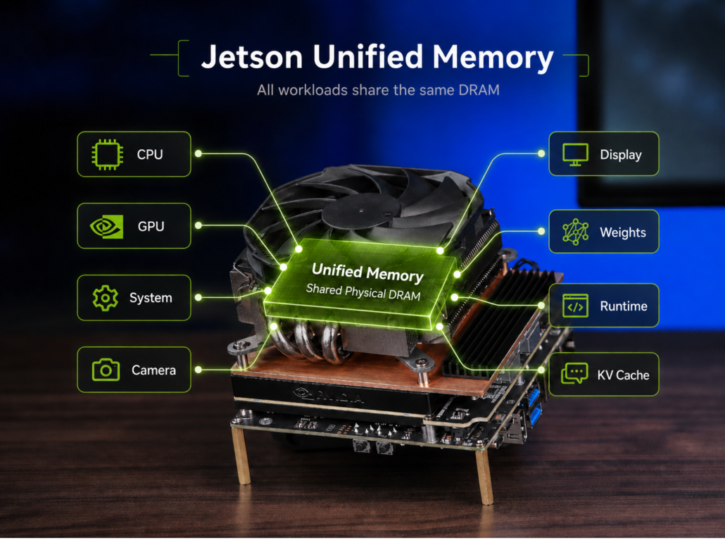

First, Why Jetson Memory Is Different
On a desktop PC, the GPU has its own VRAM and the CPU has its own DRAM. On Jetson, there is only one pool of physical DRAM, shared by everything: CPU processes, the GPU, system services, camera and display pipelines, your model weights, the inference runtime, and the KV cache.
This is “unified memory.” It means every megabyte matters twice: your LLM isn’t competing with just other apps — it’s competing with the operating system, the display server, and every background service, all drawing from the same bank.
It also means the system footprint at boot is the first line of your LLM budget. Which brings us to JetPack 7.2.

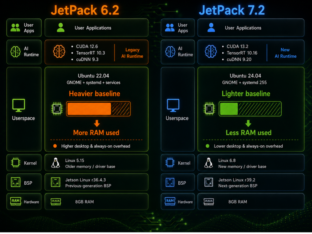

What JetPack 7.2 Actually Delivers
JetPack 7.2 ships Jetson Linux 39.2, Ubuntu 24.04, Linux kernel 6.8, CUDA 13.2.1, and TensorRT 10.16.2. It does not add DRAM to your module, automatically shrink your model, or turn on KV-cache reuse by itself. What it does is hand you a leaner baseline and better tooling to measure what you have:
  • A leaner boot footprint. In one measured Orin Nano 8 GB comparison, the settled idle state used about 1.4 GiB on JetPack 6.2 and a little over 800 MiB on JetPack 7.2 — roughly 600 MiB recovered, in that specific image and service configuration. That’s memory that stays available for weights, workspace, and KV cache instead of being eaten before your app starts.
  • Official Yocto support. When the Ubuntu dev image carries software you don’t need, a production team can now build a tailored, reproducible image with only the required services, drivers, and libraries.
  • A current CUDA + TensorRT stack, which is the baseline for the TensorRT Edge-LLM toolchain (more on that below).
Hence “software memory upgrade”: same physical DRAM, more of it actually usable.
One caveat before you get excited: the boot-footprint gain is not automatic for every image. Desktop mode, enabled services, containers, display and camera paths, carrier-board BSP settings, and where you take the measurement all move the baseline. Measure the settled idle state on your device before you assign that recovered headroom to a bigger model.

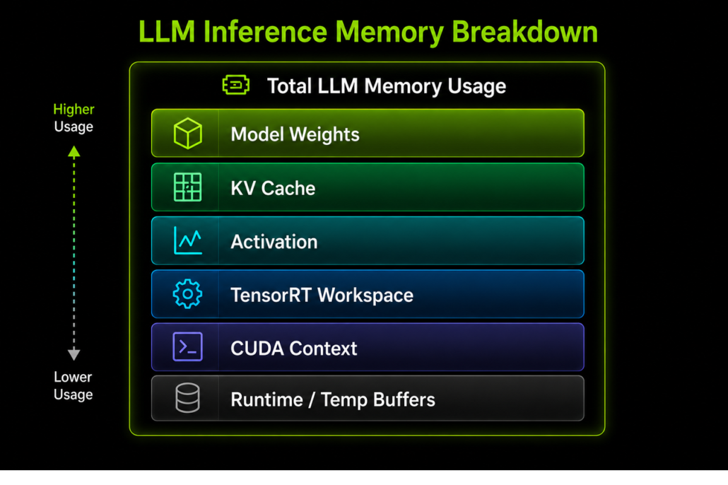

The LLM Memory Budget: Six Chunks You Must Account For
An LLM doesn’t just “load the model.” Split your usable memory into these chunks before you change a single setting:
ChunkWhat it isBehavior
Model weightsThe trained parametersBiggest fixed cost; scales with model size and precision
KV cacheThe model’s memory of the conversation so farGrows with context, batch, and concurrency
ActivationsTemporary tensors created and discarded mid-layerTransient
TensorRT workspaceScratch space for engine prep and executionRuntime-dependent
CUDA contextThe GPU “session” (context, streams, internal state)Fixed startup cost
Runtime / temp buffersI/O buffers, copy regions, intermediate scratchShort-lived
Get into the habit of thinking in these six lines. Every optimization you’ll ever apply on Jetson targets one of them.
