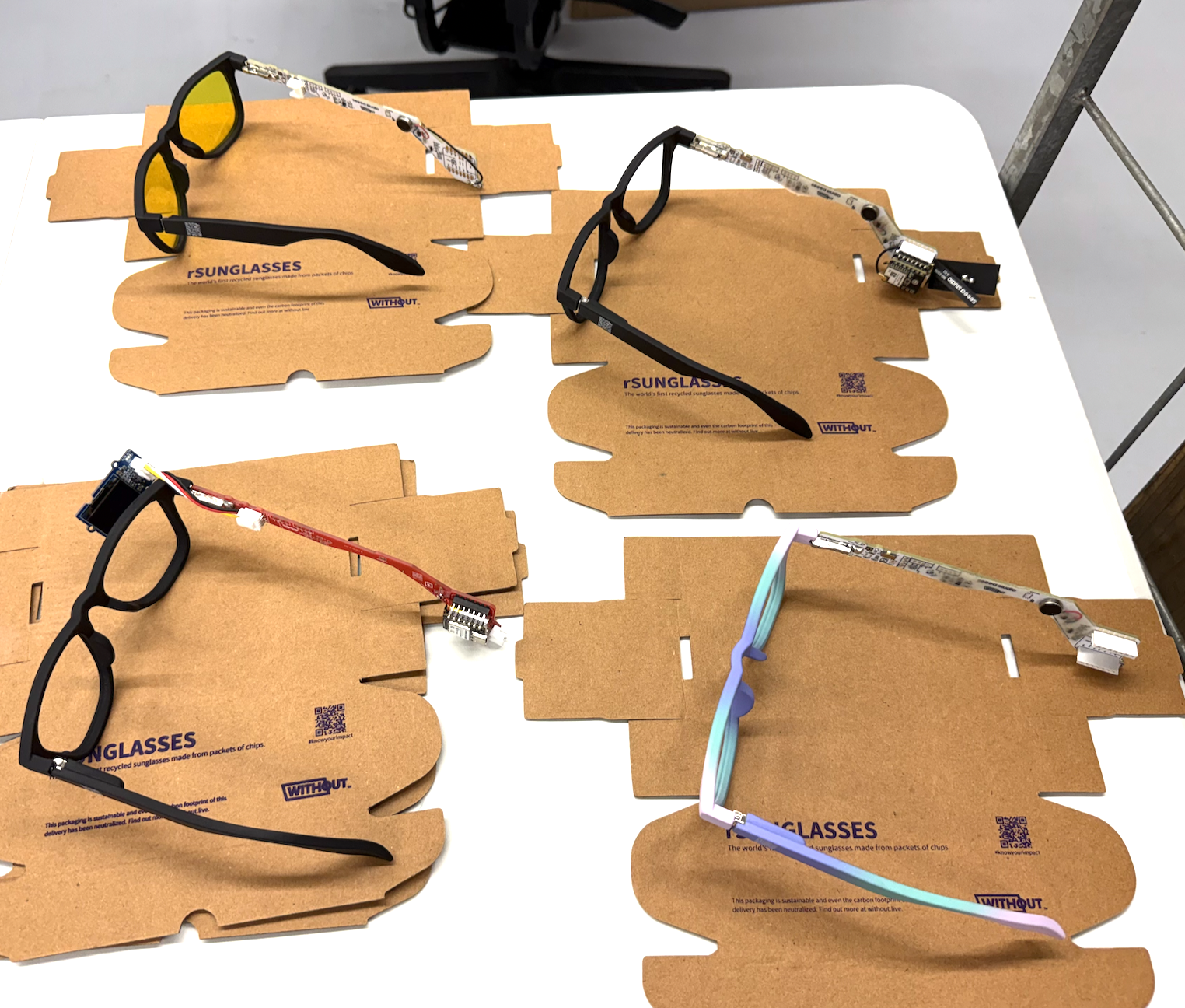

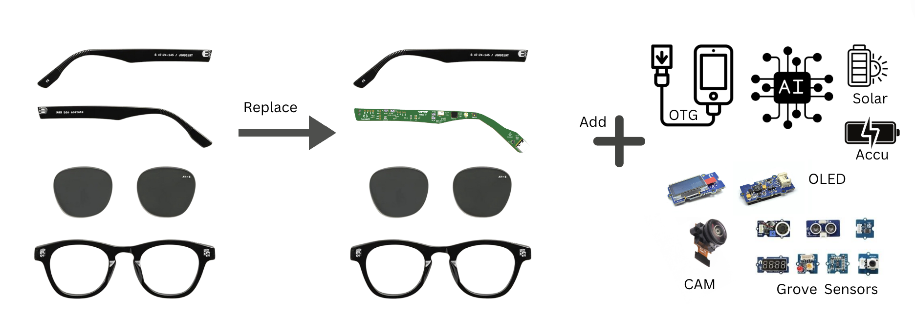

At the heart of the project is a custom PCBA shaped to replace the arm of a standard pair of glasses. It’s designed around normal eyewear hinges, mounts with the original screws, and leaves room along the temple for sensors, connectors, and a battery. For the Without® frames the hinge is soldered on; you can fit your own hinge instead, or choose the ready-to-use kit with the hinge already in place — no soldering required.

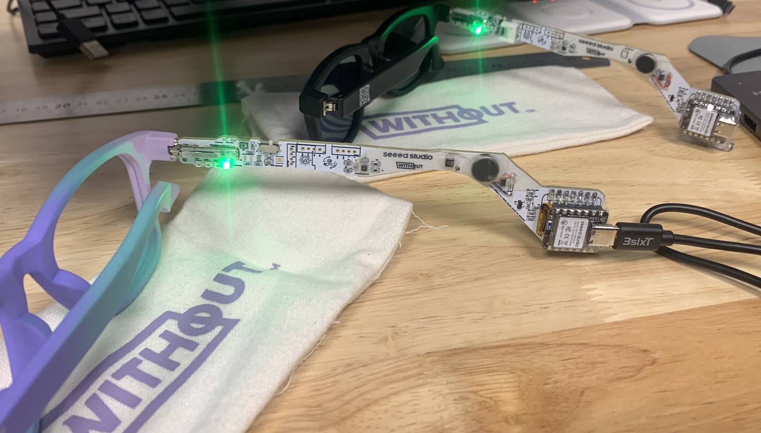

    • Seeed Studio XIAO board — fully swappable between ESP32-C6, ESP32-S3, nRF52840 Sense, RP2040, and others compatible XIAO boards
    • Custom PMSG PCBA with open-source hinge options
    • Grove 3.3 V connectors for sensor or module
    • 4× WS2812C RGB LEDs on board
    • Vibration motor for haptic feedback
    • Battery and USB-C charging/programming
    • Sensors — temperature/humidity, VOC/NOx, light and UV, IMU

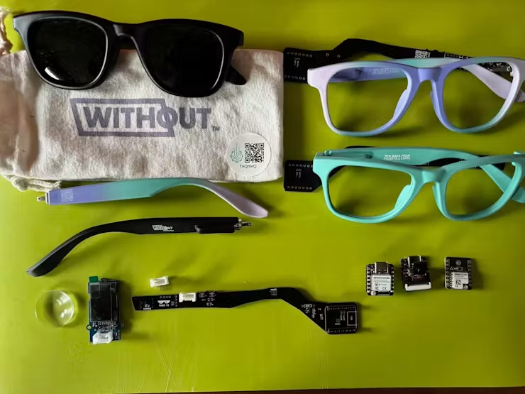

Building a pair is a five-step process:
    1. Start with the PMSG PCBA.
    2. Mount any supported XIAO board.
    3. Attach it to your frames  See https://without.live/eyewear/
    4. Plug in Grove sensors  or, later, a camera module if you want one / Lora module / NPU etc.
    5. Flash the firmware via Arduino IDE or PlatformIO.
