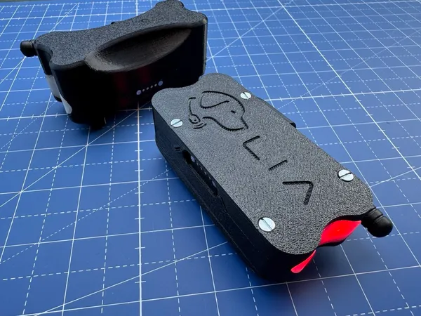

Two finished LIA enclosure variants show how the project moved beyond a bare node into a collar-ready device. Project image: J. G. Aguado.

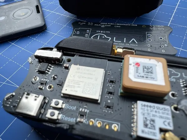

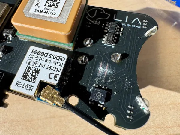

The architecture joins an ESP32-S3-MINI-1 host, a u-blox SAM-M10Q GNSS receiver, a MAX17048 battery fuel gauge, an LSM6DSOX motion sensor and a Wio-SX1262 radio module on a purpose-built board. The host does more than forward coordinates. It decides when GNSS and radio power should be available, reads the physical mode switch, handles charge and motion status, interprets commands, and chooses when a new position is worth sending.
The exposed board makes the division of labor visible: ESP32-S3 for application control, SAM-M10Q for positioning, and Wio-SX1262 for the LoRa radio path. Project image: J. G. Aguado.

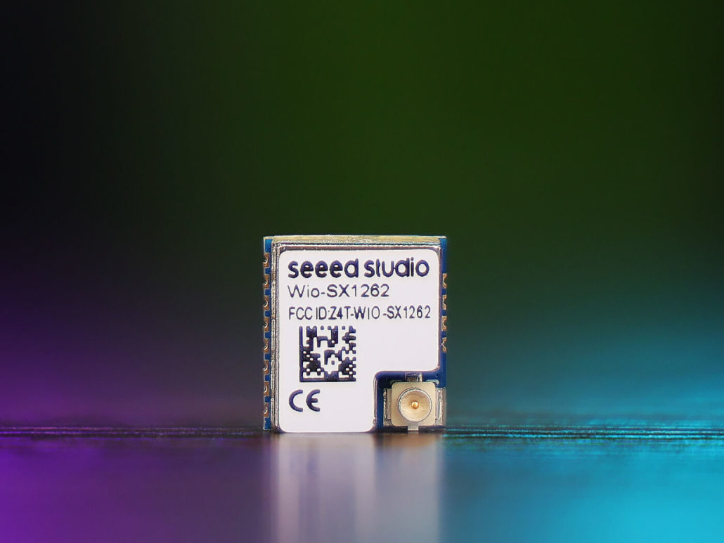

The Wio-SX1262 module packages Semtech’s SX1262 transceiver, an active temperature-compensated crystal oscillator and the RF interface in a compact module controlled over SPI. Seeed’s technical documentation provides the pinout and reference design, including the BUSY, reset and interrupt lines, DIO3-controlled TCXO supply and the antenna matching guidance. This lets the ESP32-S3 concentrate on GNSS, sensor logic and power policy while the module handles LoRa transmission and reception.
For Meshtastic builders, that separation has a practical advantage: SX1262 is already a familiar radio family in the ecosystem. The module does not remove the need for correct power sequencing, antenna layout or a board variant, but it reduces the amount of RF circuitry a maker must reinvent. LIA demonstrates the module’s real value by embedding it in a complete system and documenting the integration work above it.
BUILD WITH THE SAME RADIO Seeed Studio provides Wio-SX1262 application resources, reference material and purchase options for makers who want to develop their own Meshtastic node.

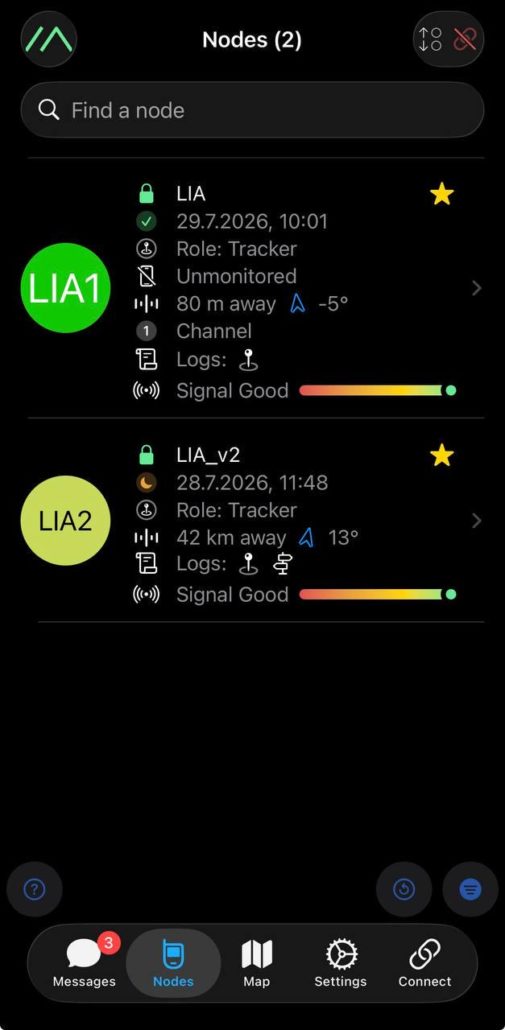

The temporary sender became a dedicated TrackerService. Stock Meshtastic support detected the SAM-M10Q, so the firmware could replace a fixed test string with a native position packet. It rejects an empty 0,0 coordinate, packages the valid position and directs it to a predefined destination node. This is an important product choice. A pet tracker should not treat every coordinate as a general announcement simply because the radio network is shared.
The privacy design also evolved through use. An early version relied on a named private channel, but users could configure the name or key incorrectly and receive no obvious explanation. Direct messages in the official app can also use identity-based encryption in ways that do not behave like ordinary channel traffic. LIA therefore simplified the model: position, status and command replies now address one known node directly. The project did not cling to its first architecture. It changed when real interaction exposed unnecessary friction.
A real LIA position displayed in the official Meshtastic app. Exact coordinates are intentionally omitted. Project image: J. G. Aguado.

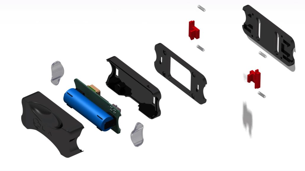

The exploded enclosure shows how the PCB, battery, light window, shells and collar attachment were designed as one mechanical system. Project render: J. G. Aguado.

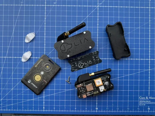

That coherence is what makes the project more than a clever radio demonstration. The photographs show hand-finished housings, visible fasteners, antenna clearances and different mounting choices. The source files let another builder inspect where those decisions came from. A reader can move from schematic to firmware service, from production data to enclosure CAD, and from a documented fault to its physical repair.
