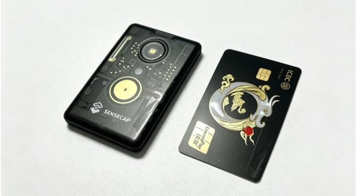

The most impressive feature of the T1000‑E is its ultra-slim and lightweight design. Sized identically to a standard credit card and only 6.5 mm thick,it can be effortlessly clipped to backpack straps or tucked into your pocket. Boasting an IP65 weatherproof rating, it withstands outdoor dust and rain perfectly.
Equipped with built-in GNSS positioning and convenient magnetic charging, the device requires no complex wiring, making it incredibly beginner-friendly. I naively assumed that I could simply unbox the tracker, power it on, connect it to the Meshtastic app, and instantly chat and share locations with friends. In reality, getting started with Meshtastic as a newbie is far from plug-and-play.

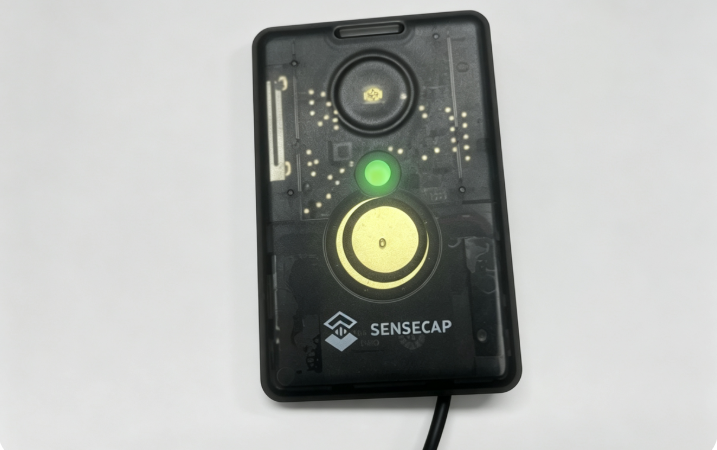

1. After receiving the device, press its button once. The green LED will stay lit for around 7 seconds with an audible beep. Afterwards, the LED will start flashing every ~0.5 seconds, indicating the device is powered on and ready for operation.

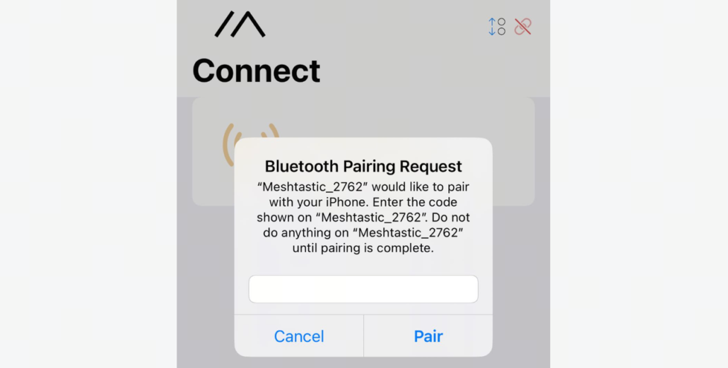

2.Download Meshtastic from your app store and turn on your phone’s Bluetooth. For first‑time pairing, all display‑free devices use the factory default PIN code: 123456. Enter this PIN to complete pairing and connect to your phone.

Why does nothing happen when I press the button sometimes?
⚠️Please note that the button is designed to prevent accidental presses, so you need to apply a little firm pressure when pressing it.
Step 1: Device Pairing & Initial Setup (My First Roadblock)
After downloading the official Meshtastic app, turning on the tracker, and enabling my phone’s Bluetooth, I struggled for a long time with device detection
Common Confusions & Issues Most New Users Encounter:
1.Pairing procedures vary slightly across different mobile operating systems, which is a common pitfall for new users. For iOS users, if nothing happens even after granting Bluetooth permission in the Meshtastic app pop‑up, you will need to manually enable Bluetooth permission for the Meshtastic app in your phone’s Settings to complete pairing successfully.
2.Keep your phone close to the tracker during pairing. Excessive distance will result in scanning failure.
3.If you have previous failed pairing records, forget the device in your phone’s Bluetooth settings before rescanning. Stale Bluetooth cache often causes connection freezes or unresponsive devices.

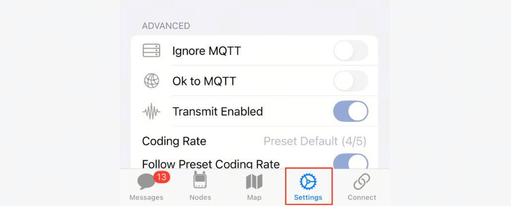

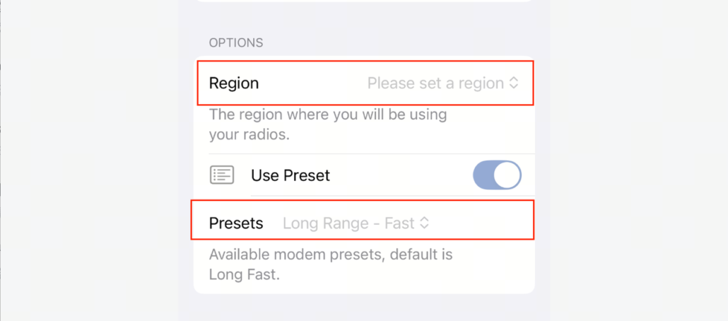

⚠️An important beginner note verified through my testing:one mobile phone can only pair with one tracker device. Once you successfully connect the device, configuring the correct LoRa Region is your top priority.
Setup path: App → Settings → LoRa, then select the frequency band corresponding to your local region. The T1000-E supports global ISM bands ranging from 863 MHz to 928 MHz
⚠️ Common Beginner Mistake: An incorrect region setting will completely disable mesh communication. Different countries and regions adopt different LoRa frequencies. Even with fully functional hardware, a frequency mismatch will prevent you from receiving any messages — this is where countless new users waste massive amounts of time.

1.All your nodes must operate within the same frequency‑band range
2.your modem presets also need to match, such as Long Range‑Fast. Even if you are both on the 863‑928 MHz band, messages will not be received by your group members if you use Long Range‑Fast while they are set to Short Range‑Fast.

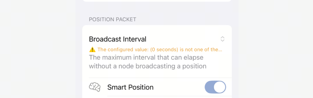

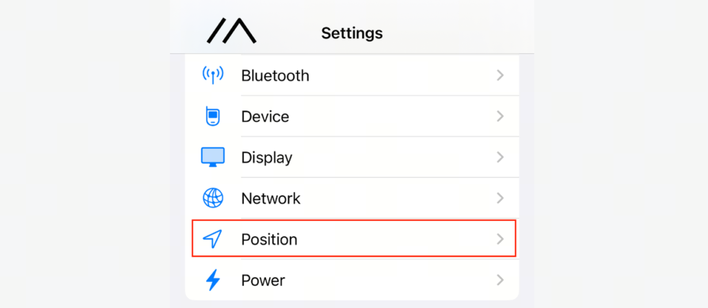

2.Battery Life Optimization
Battery performance was my big concern. Short position‑broadcast intervals drain power quickly. Many users encounter fast power drain, which is completely normal. I initially set a very short position broadcast interval, leading to rapid battery consumption. Although equipped with a professional low-power design, frequent position updates and intensive message transmission will significantly shorten runtime. To balance positioning real-time performance and battery life, beginners can switch the position broadcast interval to Medium Slow mode. Adjusting the update frequency according to your actual usage scenarios effectively extends outdoor endurance with negligible impact on daily use.
