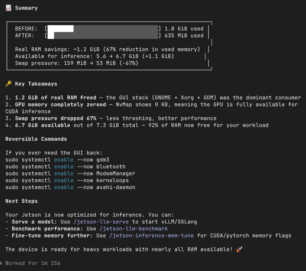

6. The Hidden Upgrade: Memory Efficiency
For edge AI, memory can be more important than raw compute.
A Jetson system does not have a separate pool of memory for every application layer. The available DRAM is shared across:
  • operating system services;
  • GPU workloads;
  • camera and multimedia components;
  • model weights;
  • TensorRT engines;
  • runtime workspaces;
  • KV cache;
  • robotics middleware;
  • application services.
That means reducing system overhead can directly increase the memory available for AI workloads.
Seeed’s JetPack 7.2 memory research highlights this point: JetPack 7.2 does not add physical DRAM or automatically shrink every model. The improvement comes from the software baseline and the ability to systematically optimize how memory is allocated.
Seeed JetPack 7.2 Memory Optimization
Seeed JetPack 7.2 Memory Optimization Deep Dive
A useful way to think about the problem is:
Physical DRAM
├── OS + services
├── GPU / CUDA runtime
├── Camera / multimedia
├── Model weights
├── TensorRT workspace
├── KV cache
├── Robotics middleware
└── Application memory
Every megabyte removed from unnecessary overhead becomes potential headroom for the workload that actually matters.
7. Seeed’s JetPack 6.2 vs. JetPack 7.2 LLM Test
Seeed compared JetPack 6.2 and JetPack 7.2 using a Qwen3.5-27B Q4_K_M workload on a 32GB-class Jetson AGX Orin configuration.
The published results were:
MetricJetPack 6.2JetPack 7.2Observed change
Memory after model load24.6 GB / 30 GB14.7 GB / 30 GB~40% lower
GPU frequency during inference930 MHz1.36 GHzHigher boost frequency
Prompt processing18.2 tokens/s25.8 tokens/s~41.8% higher
Token generation4.3 tokens/s5.5 tokens/s~27.9% higher
The most practical result is memory headroom.
In this test configuration, the JetPack 7.2 run retained roughly 10 GB more memory headroom after model loading. That matters when an LLM has to coexist with camera processing, robotics middleware, databases, APIs, or other edge services.
These numbers should be interpreted as results from Seeed’s published test configuration, not as universal performance guarantees for every Jetson device or workload.
Seeed JetPack 7.2 Deep Dive & Benchmark
8. Think About LLM Memory as a Budget
A useful LLM deployment model is:
Available DRAM
System footprint
Inference runtime
Model weights
KV cache
Application services
Actual headroom
This is why a smaller system footprint can have an outsized impact on an edge LLM application.
Seeed’s Orin Nano 8GB observations found a historical JetPack 6.2 state using roughly 1.4 GiB at boot compared with slightly more than 800 MiB in one JetPack 7.2 configuration—around 600 MiB of difference in that particular image and service configuration.
That does not mean every JetPack 7.2 system will automatically save exactly 600 MiB.
Desktop services, containers, camera paths, carrier-board BSP settings, and measurement timing all affect the result.
The correct workflow is:
Measure → identify → optimize → measure again.

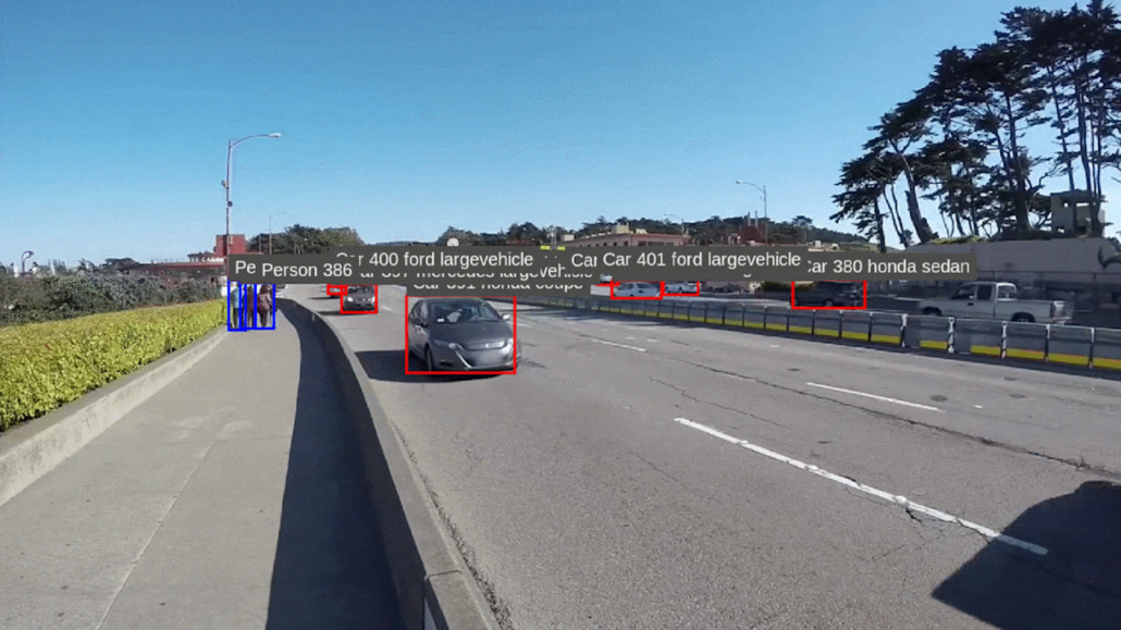

10. DeepStream 9.1: A New Video Analytics Baseline
JetPack 7.2 also changes the baseline for video analytics.
For JetPack 7.2, DeepStream 9.1 is the relevant Jetson release. Seeed’s documentation identifies DeepStream 9.1 as the first DeepStream release whose Jetson platform table explicitly targets JetPack 7.2 GA / Jetson Linux 39.2.
Seeed: DeepStream on JetPack 7.2
The baseline includes:
  • DeepStream 9.1;
  • Jetson Linux 39.2;
  • CUDA 13.2;
  • TensorRT 10.16.1.7 within the DeepStream 9.1 package baseline;
  • cuDNN 9.20.0.46;
  • GStreamer 1.24.2;
  • OpenCV 4.8.0.
Notice that the TensorRT version here is the DeepStream 9.1 package baseline, rather than the top-level JetPack 7.2 TensorRT package version. Keeping these version contexts separate avoids confusing the two software baselines.
DeepStream 9.1 also introduces a stronger agent-assisted development workflow, including coding-agent capabilities and agentic skills for pipeline construction, debugging, multi-camera tracking, calibration, and inference configuration.
