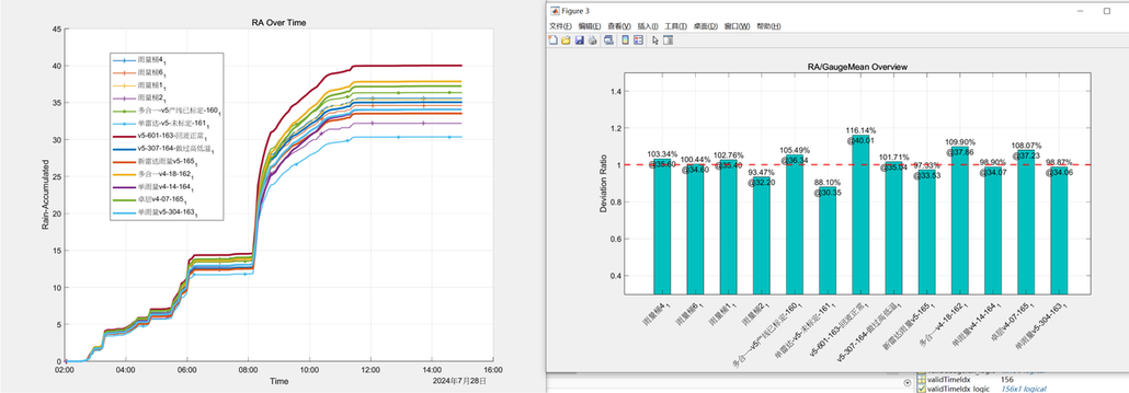

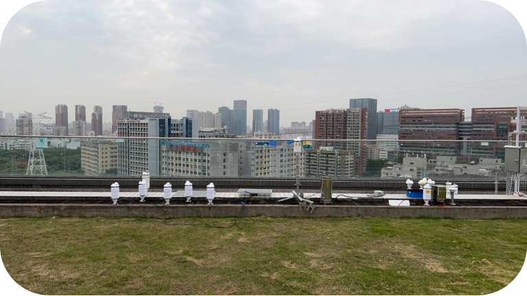

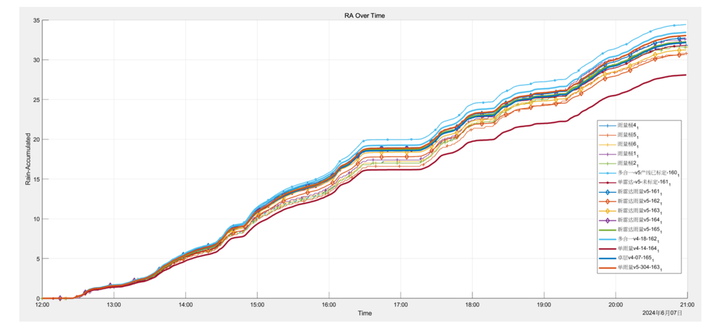

To evaluate whether the Doppler radar rainfall sensors meet their design requirements, a comparative monitoring test was conducted using multiple radar-based weather sensors and conventional tipping-bucket rain gauges.
The test involved 14 devices in total: five SenseCAP S700-C all-in-one weather stations with integrated radar rainfall sensors, three standalone radar rainfall sensors, and six tipping-bucket rain gauges. All devices were installed at the same test site and positioned at the same elevation to provide comparable observation conditions.
SenseCAP Sensor Hub 4G Data Logger by Seeed Studio was used to collect data from the tested devices. This setup enabled synchronized data collection, allowing rainfall measurements from different sensors to be compared over the same observation period.
The test was designed to assess the rainfall monitoring performance of the radar sensors against the reference measurements and determine whether their results met the product design requirements.
Test setup for the comparative evaluation of radar-based rainfall sensors and tipping-bucket rain gauges.
Continuous Monitoring and Data Collection

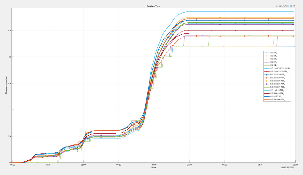

All tested devices were monitored continuously for 48 hours, during which rainfall data were collected and recorded for subsequent analysis.
After the monitoring period, the recorded data were compiled into rainfall analysis tables and measurement trend curves. These records provided a basis for comparing cumulative rainfall measurements from the radar sensors with those from the tipping-bucket rain gauges over the same observation period.
Using synchronized data collection and a common observation window helped minimize discrepancies caused by differences in recording times, making it easier to evaluate the consistency of the measurements across the tested devices.

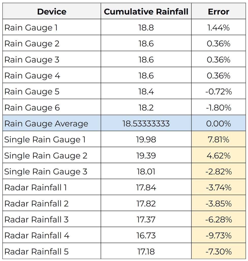

Comparison of Cumulative Rainfall Measurements Across Tested Sensors
The 48-hour comparative test demonstrated strong agreement between Doppler radar-based rainfall sensors and conventional tipping-bucket rain gauges, a widely used reference method for rainfall measurement. Under the same test conditions, the cumulative rainfall measurements from the radar sensors differed from the tipping-bucket readings by less than ±10%. This close agreement provides practical evidence of the radar sensors’ measurement precision and supports the reliability of the SenseCAP S700-C for continuous rainfall monitoring.

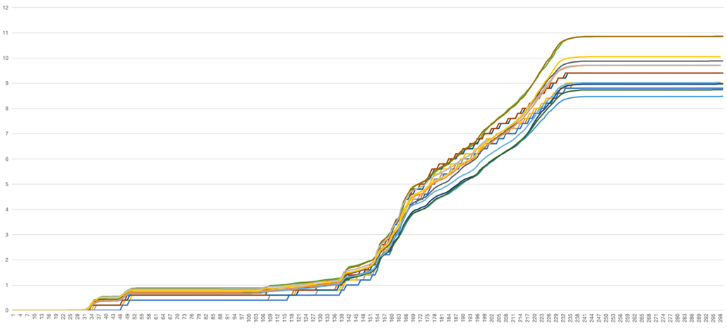

Consistency of Cumulative Rainfall Measurements Over 48 Hours
Key Findings
- High measurement consistency: The cumulative rainfall measurements from the radar sensors differed from tipping-bucket rain gauge readings by less than ±10% over the 48-hour test, demonstrating strong agreement between the two measurement methods.
- High measurement precision supported by real-world data: The close agreement with conventional tipping-bucket measurements provides experimental evidence that the radar approach can deliver reliable cumulative rainfall data under the tested conditions.
- A reliable alternative for rainfall monitoring: The results demonstrate the potential of radar-based rainfall measurement to achieve results comparable to conventional tipping-bucket gauges, supporting its use in continuous precipitation monitoring applications.

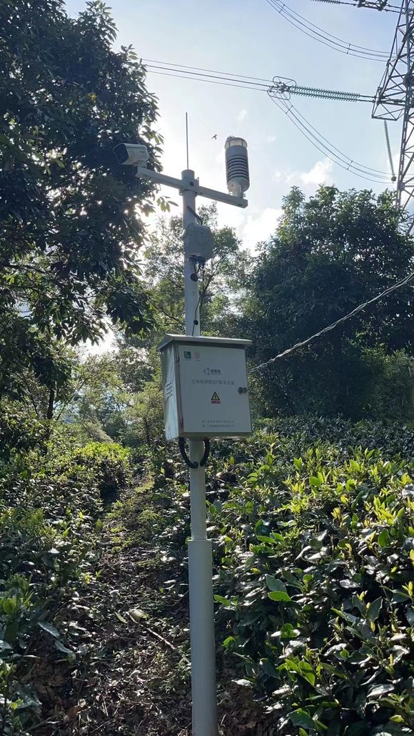

The SenseCAP S700-C combines Doppler radar-based rainfall measurement with multiple meteorological parameters, offering a way to collect localized weather data for applications that require continuous environmental monitoring. Its value extends beyond individual rainfall readings: when combined with other sensors, historical records, and application-specific models, these measurements can help build a more complete picture of local environmental conditions.
