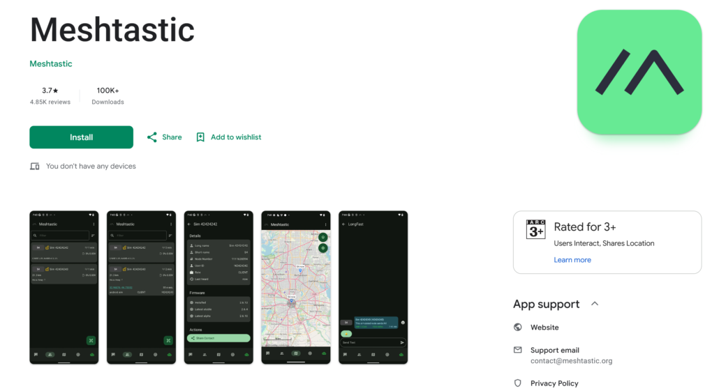

    Most users configure their nodes using the Meshtastic mobile app on Android or iOS, although desktop applications are also available. By the way, some Meshtastic devices can be configured on the device itself, that depends on what kind of devices you choosed.
  • The Meshtastic app installed
    Download and install the Meshtastic app on your phone before powering on your device.

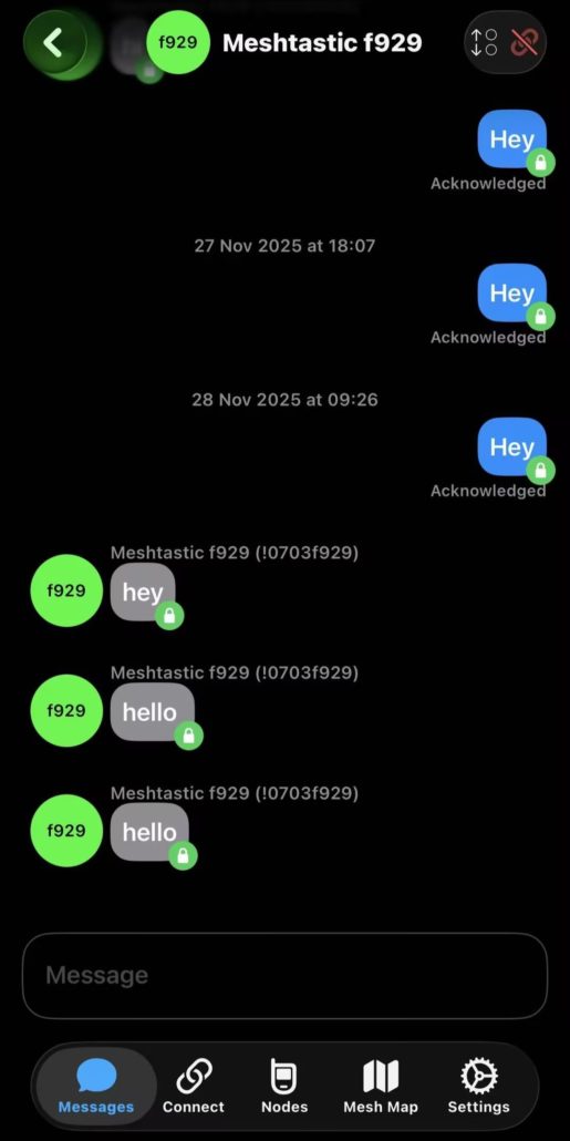

Step 4: Send Your First Message
Navigate to the chat section in the app or directly on the device, and send a message to the public channel.
If there are other Meshtastic users within radio range, they should receive your message immediately. If no one responds, don’t worry—your node is still functioning correctly. Mesh networks become more useful as additional nodes join the area.
