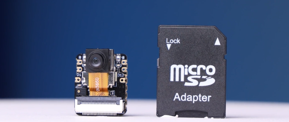

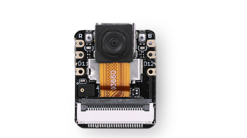

The All-in-One ESP32 Camera: XIAO ESP32-S3 Sense
The XIAO ESP32-S3 Sense is a complete ESP32 camera board that packs a camera, microphone, and storage into a thumb-sized package.
Specs:
- Processor: ESP32-S3R8, Xtensa LX7 dual-core @ up to 240 MHz
- Camera: OV3660 (upgraded from OV2640), compatible with OV5640
- Memory: 8MB PSRAM + 8MB Flash
- Storage: MicroSD slot, up to 32GB FAT
- Wireless: 2.4GHz Wi-Fi + BLE 5.0 / Bluetooth Mesh
- Dimensions: 21 × 17.8 × 15mm (with expansion board)
- Power Input: 5V (Type-C) / 3.7V (BAT)
- Deep Sleep: 3μA
- Webcam Average Power Consumption: 5V/~140mA (Type-C)
- Webcam Peak Power Consumption: 5V/~347mA (Type-C)
- Working Temperature: -20°C to 65°C
- Interface: UART, I2C, I2S, SPI, 11x GPIO, 9x ADC, B2B connector
Key Features:
- Detachable camera sensor, which is swappable with OV5640 for higher resolution
- Onboard digital microphone for voice and audio projects
- Compatible with Arduino, MicroPython, and SenseCraft AI
- No-code AI model deployment via SenseCraft AI
- Production-ready SMD design with stamp holes for PCBA integration
Applications:
- Image processing and video monitoring
- Wearable and space-limited IoT devices
- Speech recognition projects
- Smart home automation
- TinyML and embedded machine learning
The XIAO ESP32-S3 Sense is a solid all-rounder for anyone who wants camera + audio and AI capability in one tiny board. It is available in both unsoldered and pre-soldered versions.

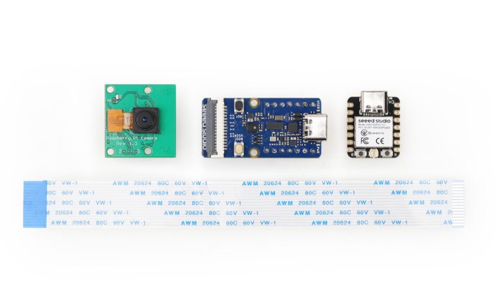

ESP32 Camera Module: Grove Vision AI V2 Kit
The Grove Vision AI V2 Kit is not a general-purpose camera board. It’s a dedicated edge AI module built for projects where inference speed and accuracy actually matter.
Specs:
- Processor: Himax WiseEye2 HX6538, dual-core Arm Cortex-M55
- Big Core: Up to 400 MHz | Little Core: Up to 150 MHz
- AI Accelerator: Integrated Arm Ethos-U55 microNPU @ up to 400 MHz
- Internal Memory: Up to 2432KB SRAM + 64KB ROM
- Interface: CSI, I2C, UART, SPI, Type-C, Grove
- Power: 5V input
- Communication Rate: 115200
Key Features:
- Dedicated Ethos-U55 neural network unit for fast on-device inference
- Supports TensorFlow, PyTorch, MobileNet V1/V2, EfficientNet-lite, YOLOv5 & v8
- No-code model deployment via the SenseCraft AI platform
- Onboard PDM microphone and SD card slot
- Fully open source. All code, schematics, and design files are available
- Compatible with XIAO series, Arduino, Raspberry Pi, and ESP32 dev boards
Applications:
- Industrial quality inspection and predictive maintenance
- Smart city equipment monitoring
- Intelligent agriculture and environmental sensing
- Wearable and handheld IoT devices
- Real-time object detection and face recognition at the edge
The Grove Vision AI V2 Kit starts at $15.99 for the module alone. For anyone serious about on-device computer vision, it’s the most capable option in this price range.

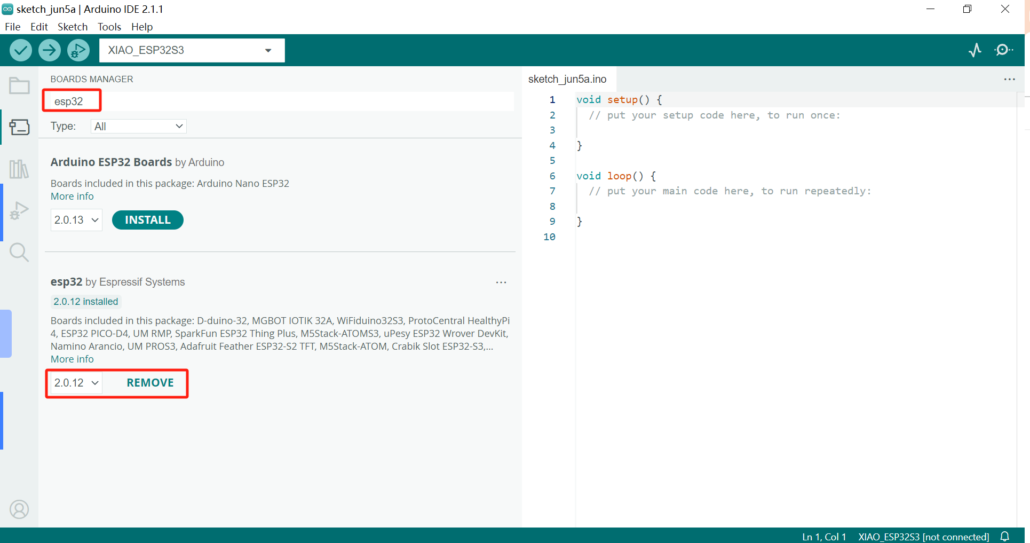

Software and IDE Setup
Both boards work with the Arduino IDE, which is the easiest starting point for beginners. You will need to add the ESP32 board package to your IDE, install the relevant libraries, and select the correct board and port before uploading any code.

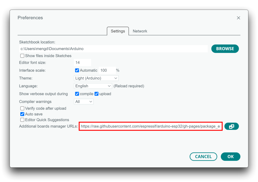

Let’s take XIAO ESP-32-S3 Sense as an example and look at the software and IDE setup:
- Download, install, and launch Arduino IDE.
- Add ESP32 board package:
- Go to File > Preferences, and fill “Additional Boards Manager URLs” with the URL: https://raw.githubusercontent.com/espressif/arduino-esp32/gh-pages/package_esp32_index.json
- Go to Tools > Board > Boards Manager… > search for “esp32” and install the latest version.
- Select the board and port. Search for “xiao” in the development board and select “XIAO_ESP32S3“.
Afterward, you are now all set to upload your first code. For the complete step-by-step software setup for the XIAO ESP32-S3 Sense, refer to the official wiki here.

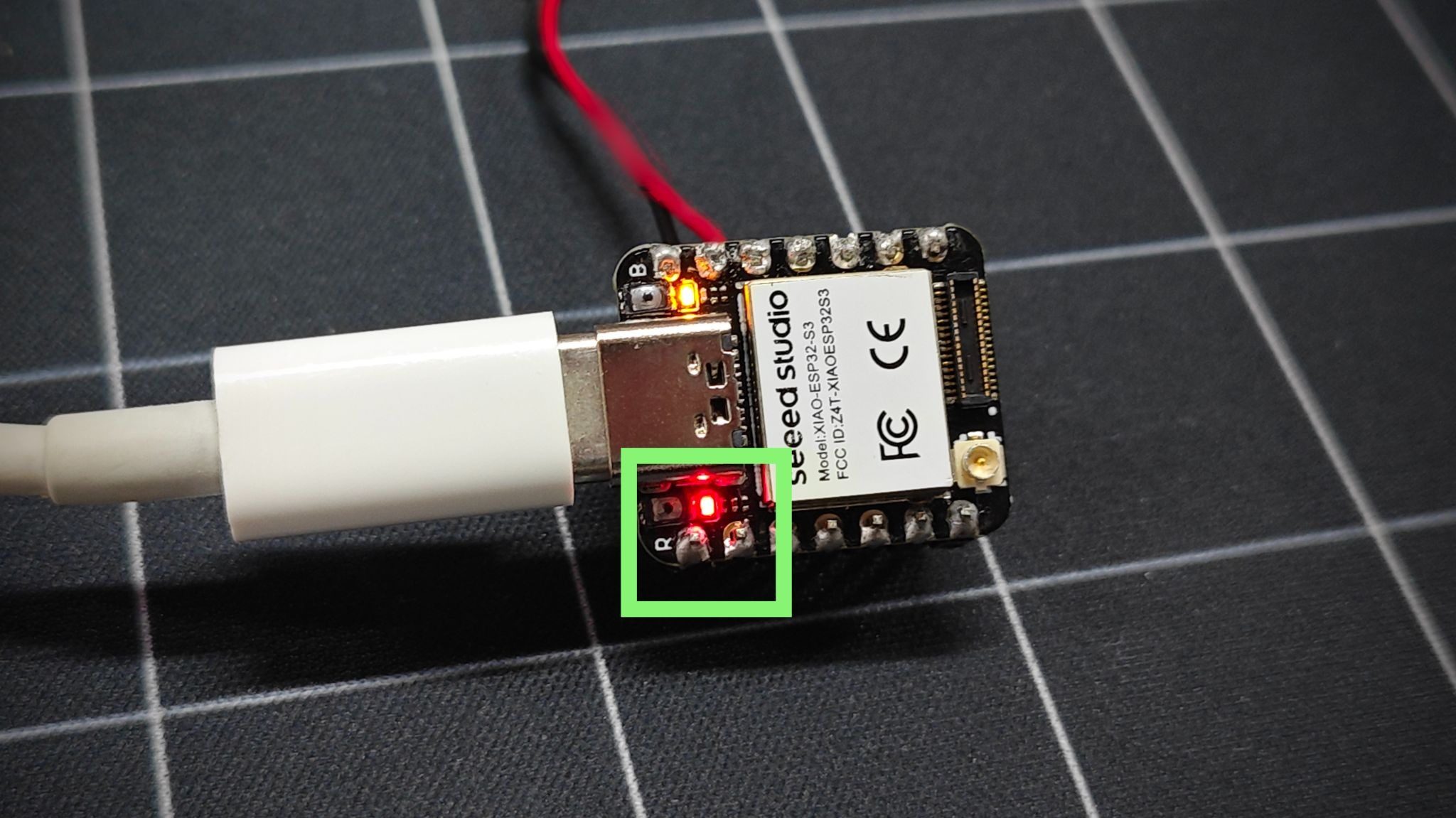

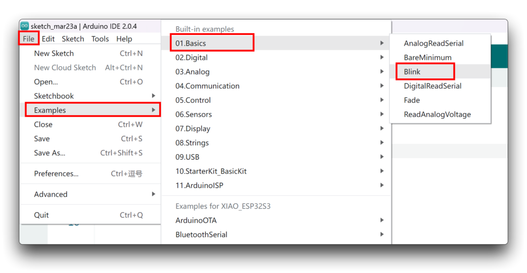

For a quick example, let us share the simplest Blink program to try on XIAO ESP32-S3:
- Launch Arduino IDE and go to File > Examples > 01.Basics > Blink.

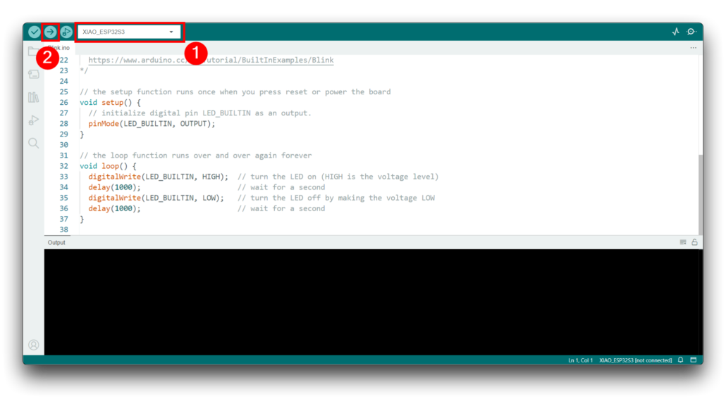

- Select the “XIAO ESP32-S3” board and the correct port number.
- After uploading, you can see the orange LED blinking on the board.

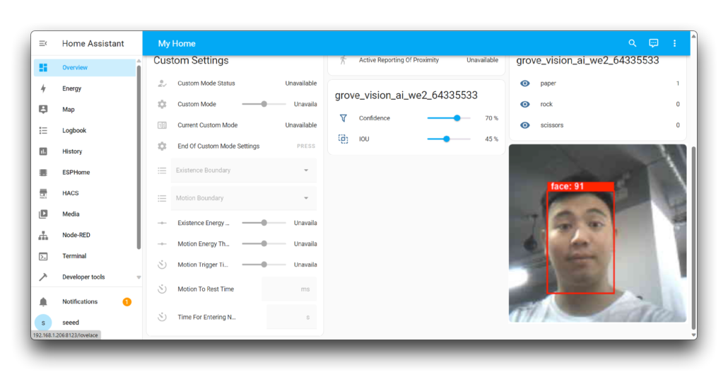

For example, you can integrate Grove Vision AI V2 into Home Assistant through the SenseCraft-HomeAssistant plugin, available via the HACS store. After connection, it enables real-time visual sensing and customized automations, such as triggering lights, sending alerts, logging activity based on what the camera actually sees, etc. You can also deploy AI models, such as object detection and face recognition, without relying on the cloud. Learn more about this project here.

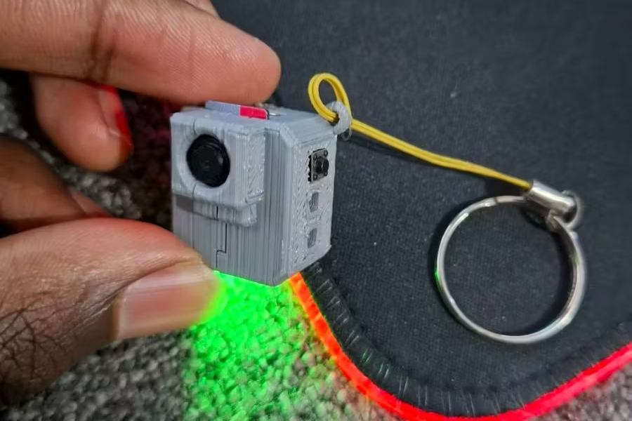

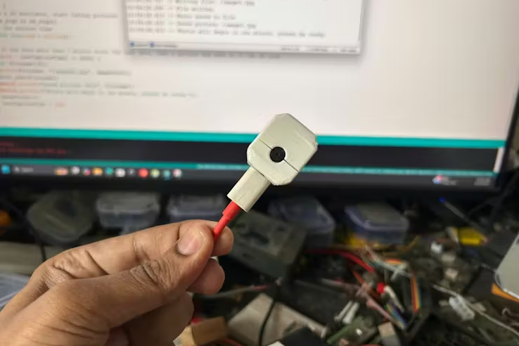

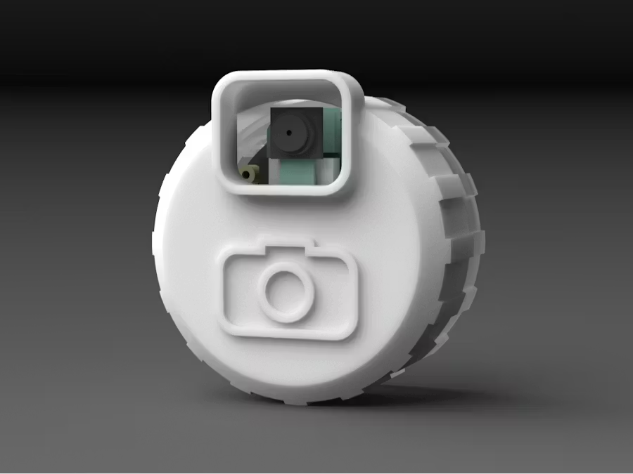

- Smallest DIY Spy Cam: Build a pocket-sized camera using the XIAO ESP32-S3 Sense that captures images with a button press and saves them directly to an SD card. A great first hardware project with a satisfying result.
- 3D Printed Mini Time-Lapse Camera: Combine the XIAO ESP32-S3 Sense with a 3D-printed enclosure to build a portable time-lapse camera for capturing sunsets, plant growth, construction progress, etc.

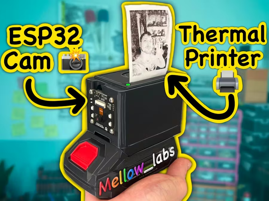

- ESP32 Instant Camera: Build a Polaroid-style instant camera that captures a photo and prints it on the spot.

- Round Screen DIY Camera: Build a fully functioning point-and-shoot camera using the XIAO ESP32-S3 Sense paired with a round OLED display. Double-tap the screen to capture an image and save it to the SD card.

Storage Options
The MicroSD card slot accepts cards between 4GB and 32GB formatted in FAT32. This gives you plenty of room for thousands of photos or hours of video. Class 10 cards are recommended for streaming and continuous capture, as slower cards can cause write bottlenecks.
